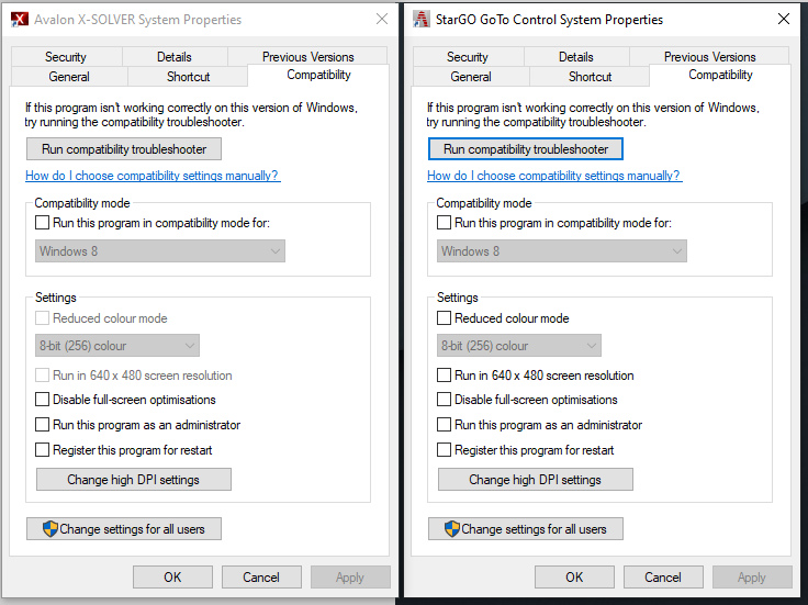

Such disconnection behaviour may be connected to the administrator privileges settings.
Try to check if the X-solver run with the same administrator privileges of the StarGo software (see attachment, in our case works fine with both tools "without administrator privileges").
