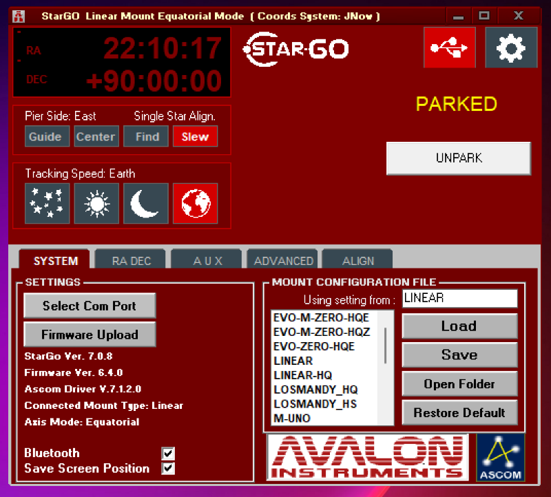

15 Feb 2023 18:52 - 15 Feb 2023 19:00 #1113 by MarkH
I have to say I'm confused as well. Here is a screenshot of my Windows based Stargo software control panel. Note that the Stargo version is 7.08, loaded from the latest 640_SP6 package on the Support page. However the firmware seems to be version 6.40 from some time ago. I also seem to have a version 7 firmware file (SG_FW_v7.0.0a) I downloaded from somewhere but I haven't loaded it as I'm not sure if it will match the version 7.08 Stargo software loaded via the version 640_SP6 package. Does my firmware and software versions look self-consistent, please? Thanks

16 Feb 2023 13:04 #1114 by Stefano82
Replied by Stefano82 on topic Stargo firmware confusion - SGP / Nina / Voyager
Hi Mark
Your software configuration is correct.
The "StarGo Ver. 7.0.8" identify the .exe version, that comes with the latest 640_SP6.
If you have also firmware file version 7, is probably because you have previously installed the 7.0.0.
So never mind what you see in the Firmware Upload folder, for this version and for your Linear mount you should use the Firmware 6.4.0 together with the 7.0.8 StarGo Ver. exe.

16 Feb 2023 16:56 #1115 by MarkH
Perfect, thanks Stefano :-)
