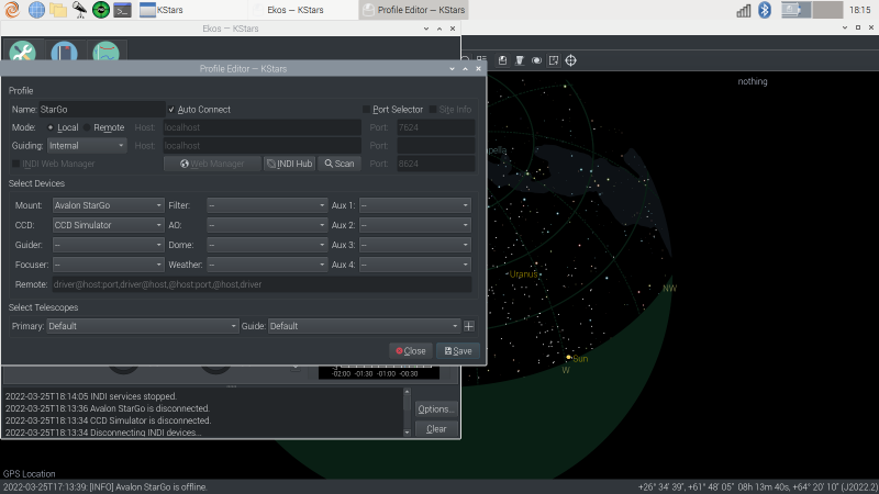

25 Mar 2022 17:38 - 31 Mar 2022 07:07 #907 by Stefano82
Replied by Stefano82 on topic guida interna StellarMate
In order to connect the StarGo to Stellarmate, you have to connect the StarGo board to the Raspberry via USB cable.
Afterwards in the KStars app create a new profile and, in the "Select Devices" panel, select the "Avalon StarGo" driver from the "Mount" dropdown menù (see attachment).
Then it will be possible to use it also the Stellarmate App for smart device by selecting in the Equipment panel the "Avalon StarGo" driver from the Mount dropdown menù list (see attachment).
