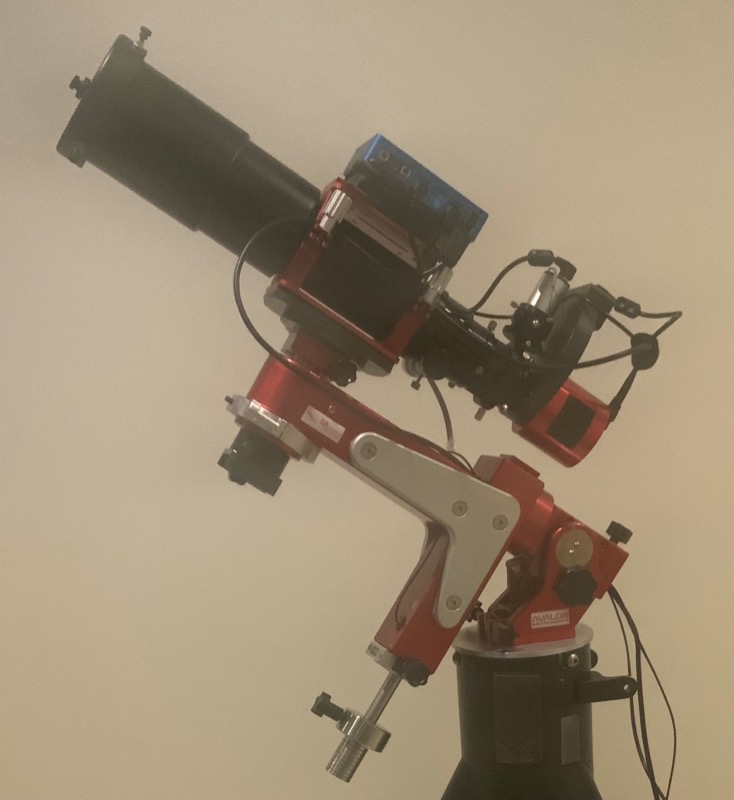

Hello all,
does anyone have a good tip on how I can operate an Apo with filter wheel and OAG on my Avalon M-Zero? The OAG touches the bottom of the mount. If I turn the filter wheel and OAG to the side, it might just fit, but I wouldn't be very flexible with the rotation. My only idea would be to put an extension between the OAG and the filter wheel and then rotate the OAG.

26 Sep 2021 17:12 #693 by Dane
Replied by Dane on topic M-Zero - Using with Filterwheel and OAG
Hi! Thanks for the input. I really forgot that you can move the arm. Unfortunately that doesn't help either, I have now moved the arm to the top position, unfortunately not enough. See the photo: ibb.co/nk5d3f4
I have now ordered rise blocks, which I can install between pipe clamps and prism rail. This is probably the only option. -> www.astroshop.eu/miscellaneous/primaluce...30mm-spacers/p,52235
