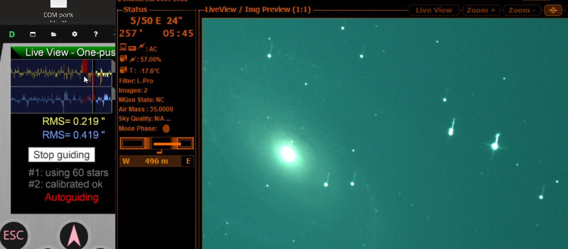

I encounter sudden guiding "bars" (not only short spikes but for several seconds) which seem to happen randomly.
MGEN2 or MGEN3 is connected via ASCOM (actually no other workaround in APT). The dithering after each image runs regularily.
personally my impression is this happens more likely when pointing to the zenith.

my impression is it seems to be a kind of backlash problem - with a backlash-free mount?
How can it be?

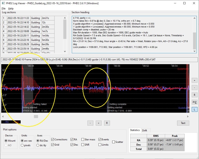

19 May 2022 12:23 - 19 May 2022 15:25 #947 by RickB
Peter, I am also seeing significant DEC backlash and can only dither RA. When I look at a DEC dither on the PHD2 logs it can still be settling 30 -90 seconds later depending on how big the dither is. I noticed that PHD2 will issue a settled command back to the imaging software and sometimes the DEC axis is still moving. So those streaks you see might be the movement at the start of the image capture while the DEC axis is still moving.
If the dither command sends the DEC axis in the same direction it was previously moving then there is no backlash to remove and it will settle before the image capture.
The attached picture shows a dither in which it took a long time for the DEC to finish. You can see PHD2 gave a settle failed before it was finished. I did have some small tails on stars for that capture.
Try to dither in RA only and see if that helps.

08 May 2023 09:50 #1156 by Peter_S
Rick, I could solve this particular problem by making APT a longer pause after dithering; the exposure began when settling after dithering was not yet completed.
