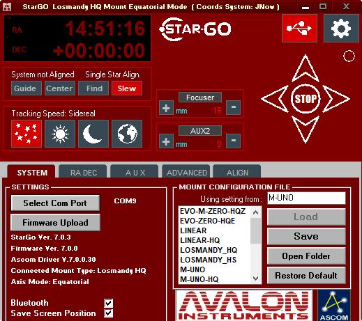

We tried to reproduce your behaviour here at the laboratory, including the park/unpark features, following the workflow listed below:
- Software connection (via USB cable)
- Sync Home Position
- Slew to object
- Set park
- Slew to different object
- Park
- Unpark
- Slew to home position
We used the latest StarGo software/firmware/ASCOM driver as listed below (see also attachment):
- StarGo Ver. 7.0.3
- Firmware Ver. 7.0.0
- Ascom Driver V. 7.0.0.30
- Connected mount Type: Losmandy HQ
- Axis Mode: Equatorial
We use the StarGo System reliably in several remote observatories and other users does since 12 years, sometimes is only required some assistance to find the reason of the issue and we always find the solution.
In order to understand the different motor speed issue try the switch the motor cables ( RA / DEC ) to see if is a connector or a motor problem.
Furthermore we are also available to help you check your whole set up configuration with a remote desktop session and if it doesn't work in this way you can even send us here at the company the StarGo box with the kit, in this way we can perform a full software/hardware check and send you back everything checked and tested.
Please in the meanwhile let us know which PC and Operative System are you using and if you are using a HUB for the USB connection.
In case you wish to proceed with a remote session please let us know via mail your availability day and time.
Feel free to ask for any further information

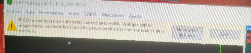

Hi again
I tried with the new version of StarGo.
Same problem and one more. Yesterday PHD2 it was working fine. Today, after update... (see attached file)
Things are getting better.
