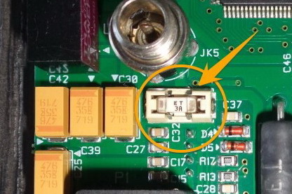

In case you cannot establish a connection with the StarGo, you can try to replace the 3A fuse circled in orange in the attached picture.
Try to perform the suggested checks and let us know about.

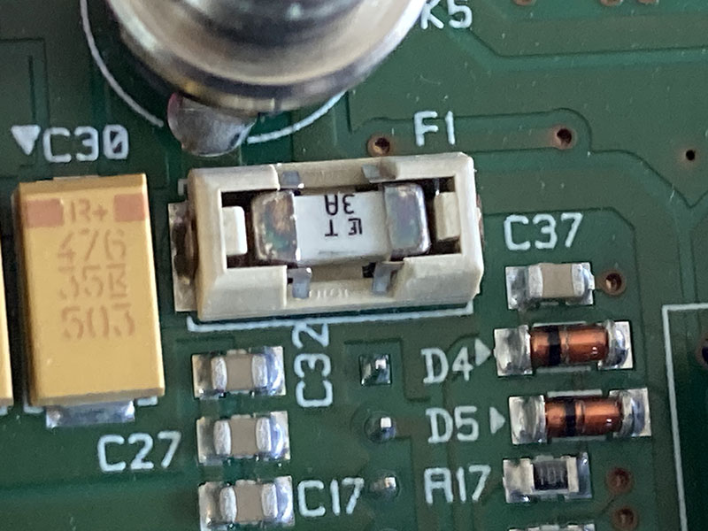

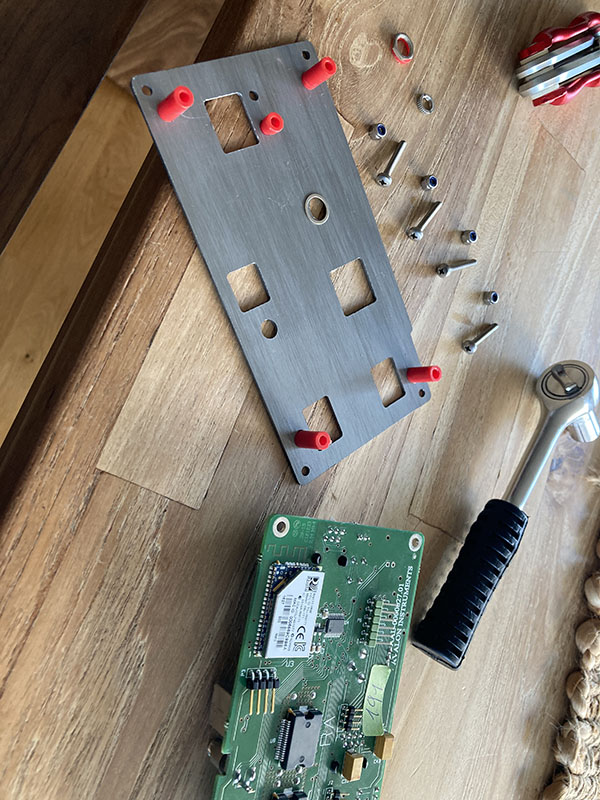

Thank you Stefano,the first method had no result unfortunately.So I ordered a 3A fuse as per your description. After it arrived today, I disassembled the StarGO unit (see photos attached) and changed the fuse. This was a little bit scary but actually not too difficult. Et voila! It works again. So my LINEAR has been saved from stupidy by the little saviour in the last image!
This is good to know for future reference...Again, thank you very much for your help!All the BestFrank
